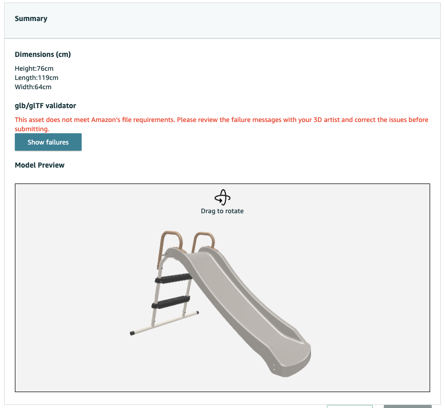

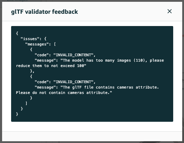

Now the issue; Every time i upload the .GLB file in Amazon i get the same error;
“code”: “INVALID_CONTENT”,
“message”: “The model has too many images (110), please reduce them to not exceed 100”
“message”: “The glTF file contains cameras attribute. Please do not contain cameras attribute.”

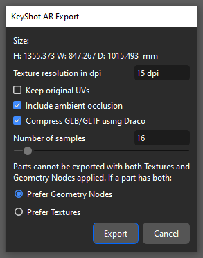

The error seems clear, so i went back to Keyshot. I’ve cleaned-up my Keyshot file. Removing un necessary models, lights, camera’s, environments etc. After that i started fiddling with the export settings (samples, dpi) but this made no difference.
Amazon_AR%20issue_3
Is it possible to create a .GLB file with Keyshot that complies with the requirements from Amazon or do i have to search for a different solution?

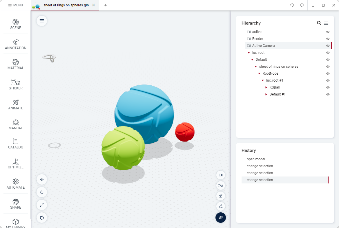

I have the same problem
“The glTF file contains cameras attribute.”
even though there is no active camera. let’s wait for some luminaries …
The free camera is translated as “active camera”, when exporting glTF or glb file
